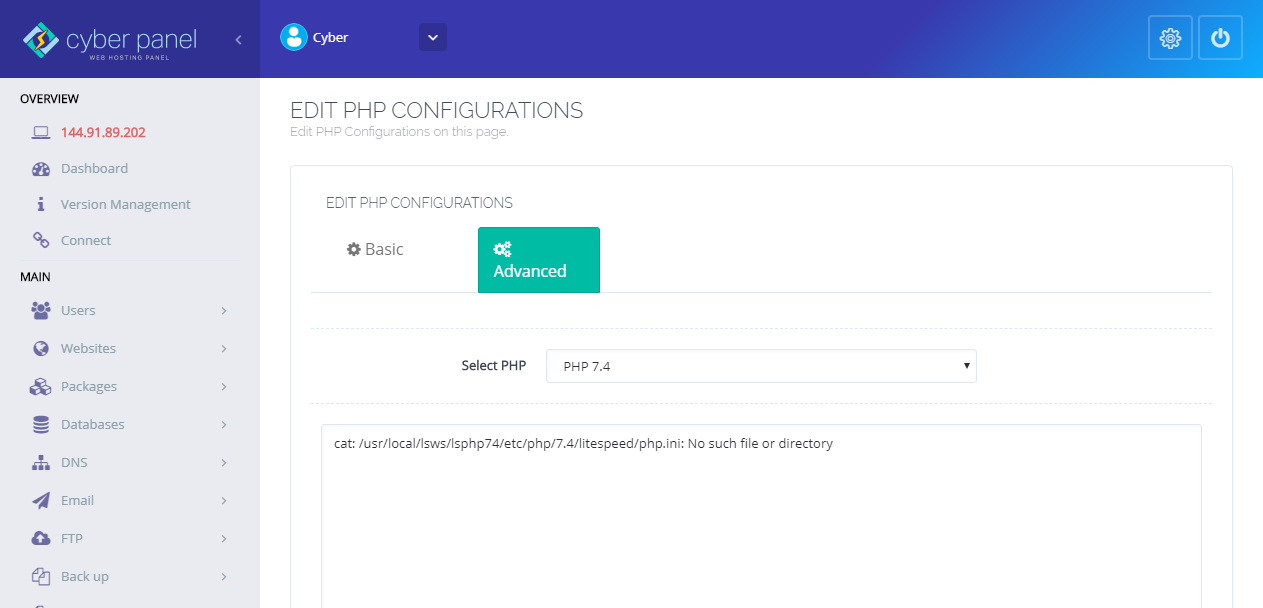

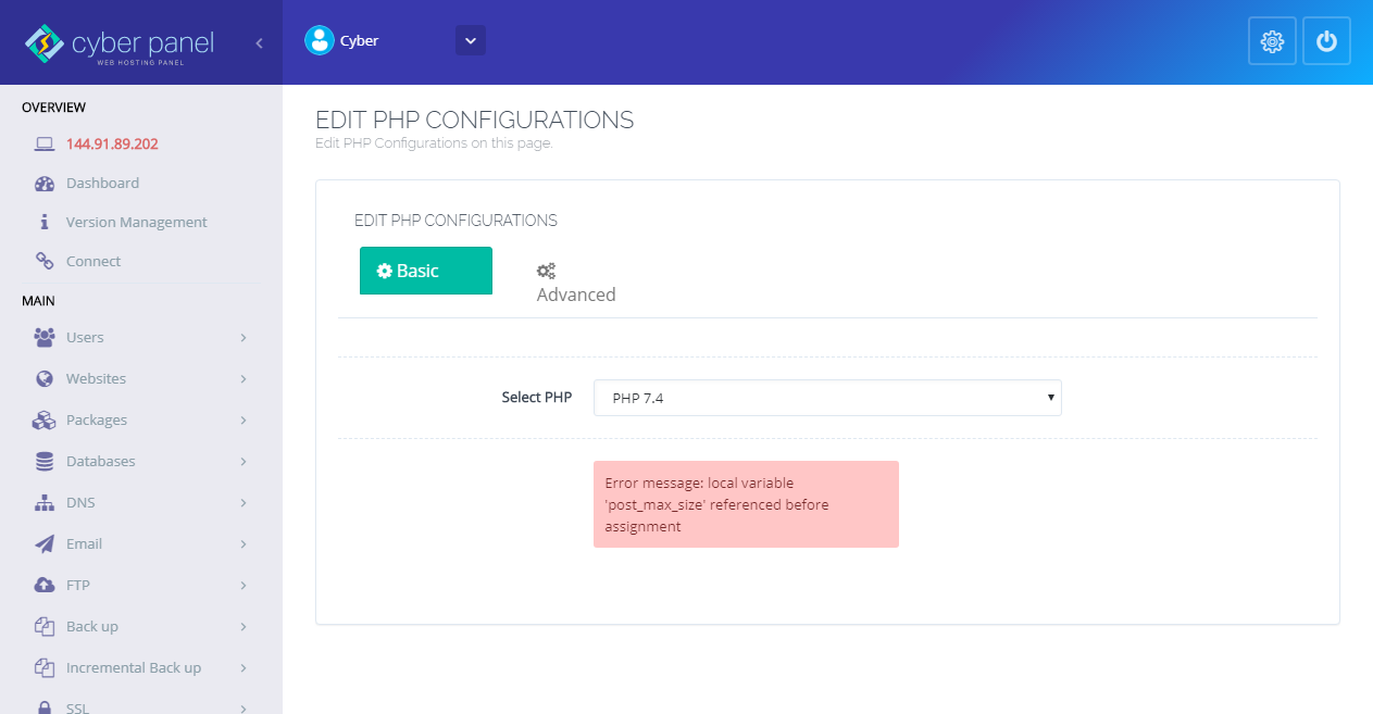

I just installed CyberPanel on my VPS. When i try to edit php configurations i got this error message " local variable ‘post_max_size’ referenced before assignment". Also when i switch to Advanced i got another error "cat: /usr/local/lsws/lsphp74/etc/php/7.4/litespeed/php.ini: No such file or directory
". Please help me to get this working.

Error message: local variable ‘post_max_size’ referenced before assignment
