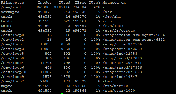

Again Inodes uses increased by 3% without hosting any domain. When Inodes was 100% uses, I’m not able to do any thing then i faced server error 505. After that I increased volume stroage by 10GB then Inodes changed to 100% uses to 86% uses. But, again it was increasing automatically. I’m afraid now because how much storage i have to increase. Because when i check storage uses then its shows only 37% uses, 63% is waist and i haved to pay for 63% storage.
I increased 30Gb one by one because Inodes was always full in few days after incresing the volume. This is very serious issue. I will provide you the screenshot of list of files which is using most Inodes. The in left side of file name is Inodes uses.
You can also check my storage uses in below screenshot.
Screenshot 2022-10-25 164313
Please provide me method form which i find out the useless file which is eating more Inodes. And any method to modify the Inodes.

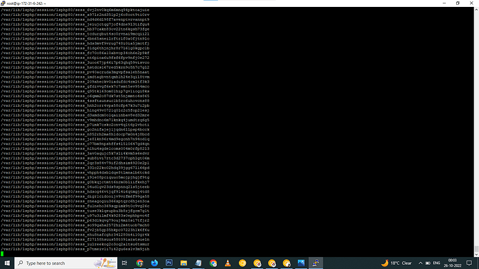

Have you checked your sessions folder, if it’s just filled with thousands of small files?
Do you please help me how to find the session folder and delete all unnecessary session files.
How to do that. Please guide me to rollback the server later date.
Inside those folders:
/var/lib/lsphp/session/lsphp71
/var/lib/lsphp/session/lsphp72
/var/lib/lsphp/session/lsphp73
/var/lib/lsphp/session/lsphp74
/var/lib/lsphp/session/lsphp80
/var/lib/lsphp/session/lsphp81
It should have many of those files, because devs never correctly set up the clean of sessions (last time I checked).
If that’s the case, I will post the fix here (but you will need to re-apply every time you update cyberpanel)

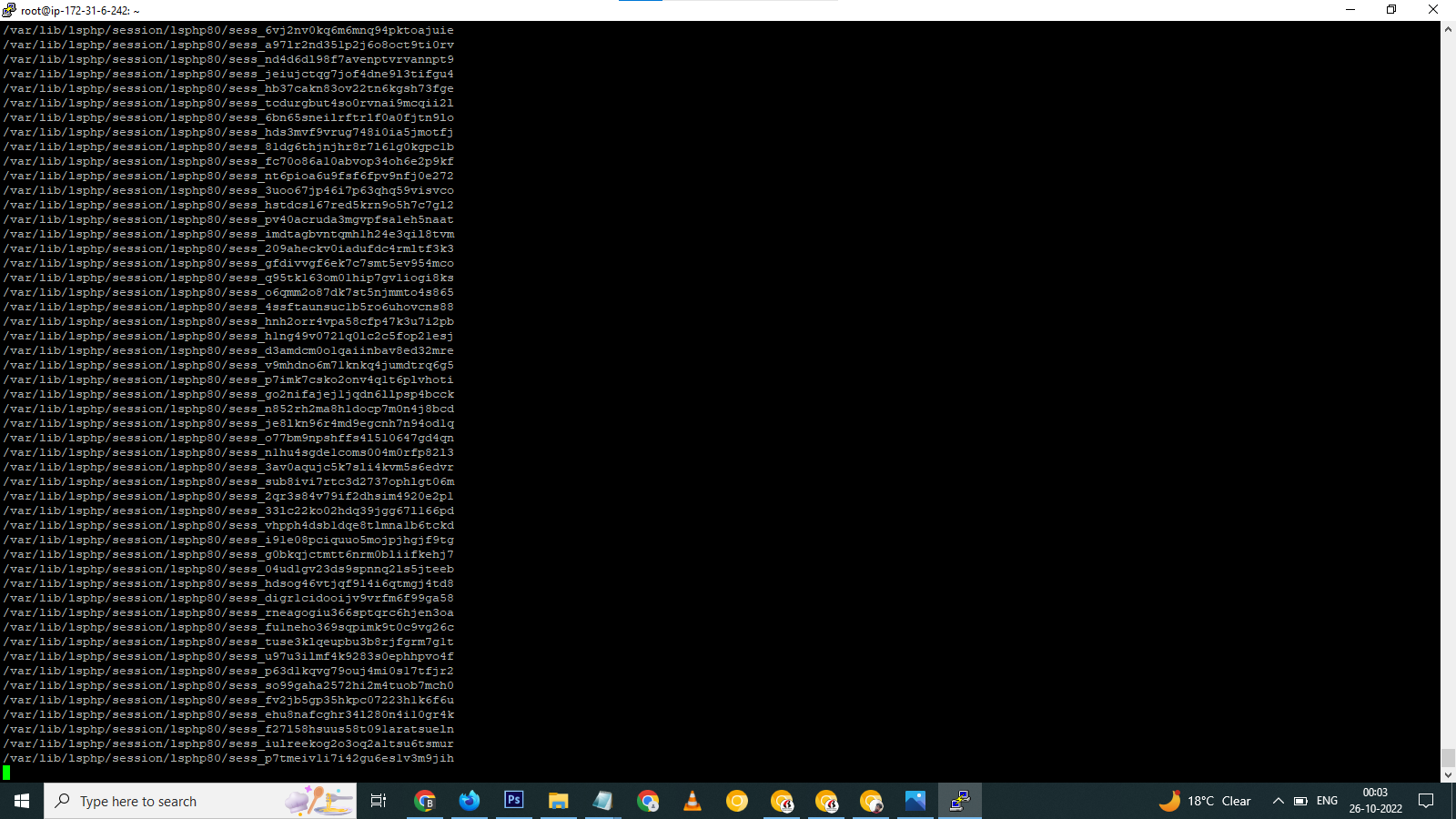

After running below command it shows me unlimited number of files. Please help me to delete these files
find /var/lib/lsphp/session/lsphp80
Still it was showing me files. How to delete these files

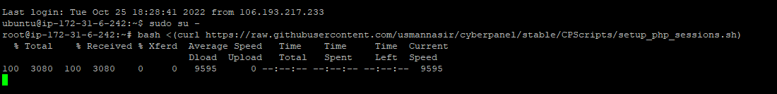

@usmannasir fixed this. Just run this if its PHP sessions
bash <(curl https://raw.githubusercontent.com/usmannasir/cyberpanel/stable/CPScripts/setup_php_sessions.sh)
Finally run
# Reload systemd manager configuration. This will rerun all generators (see systemd.generator(7)), reload all unit files, and recreate the entire dependency tree. While the daemon is being reloaded, all sockets systemd listens on behalf of user configuration will stay accessible.
systemctl daemon-reload
systemctl restart lsws
I think it is running.

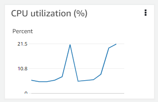

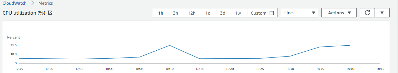

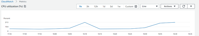

Check server load now
Screenshot 2022-10-26 001940
The script I posted Installs a PHP Session cleaning cronjob. Try and reboot the server

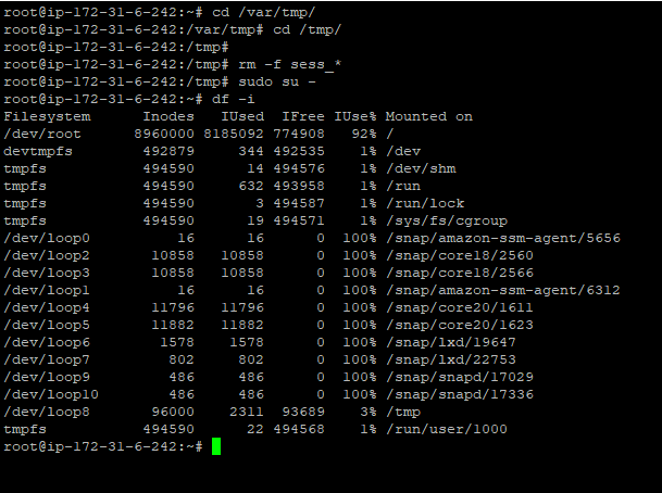

I checked the Inodes uses after running the PHP Session cleaning cronjob script and restarting the server. Its still same.
Screenshot 2022-10-26 003402

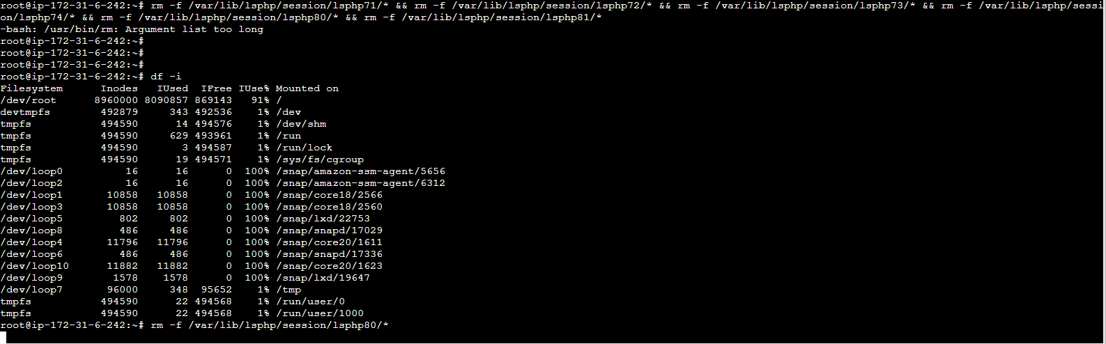

Do this manually. Run this command to delete all files:
rm -f /var/lib/lsphp/session/lsphp71/* && rm -f /var/lib/lsphp/session/lsphp72/* && rm -f /var/lib/lsphp/session/lsphp73/*
rm -f /var/lib/lsphp/session/lsphp74/* && rm -f /var/lib/lsphp/session/lsphp80/* && rm -f /var/lib/lsphp/session/lsphp81/*
Run these commands separately
Now Inodes free by 1% still running this command. Now CPU uses goes to 90%
Getting this again & again
-bash: /usr/bin/rm: Argument list too long
