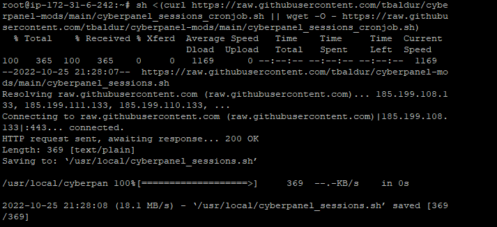

Editing the cleansessions above is enough (runs twice per hour), but, just in case to be sure, you can add another cronjob outside of cyberpanel logic. That way you can safely update cyberpanel in the future:
sh <(curl https://raw.githubusercontent.com/tbaldur/cyberpanel-mods/main/cyberpanel_sessions_cronjob.sh || wget -O - https://raw.githubusercontent.com/tbaldur/cyberpanel-mods/main/cyberpanel_sessions_cronjob.sh)
This will create the script to delete the sessions and set up crontab to run the said script every hour at the 17th and 47th minute.
Thank you very much Tmoore, I’m facing this issue form many weeks and i know what was the problem but, I have not any knowledge of Linux. So, I’m not able to fix the issue and i’m increasing the storage day by day. You solved this issue in few hours.
