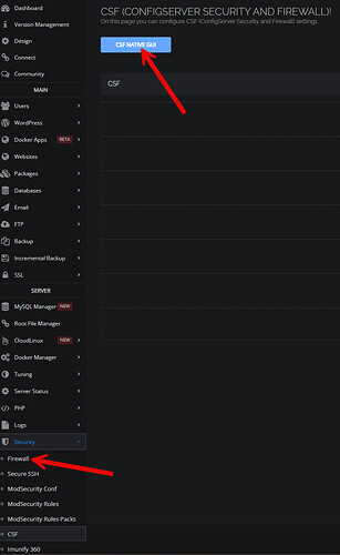

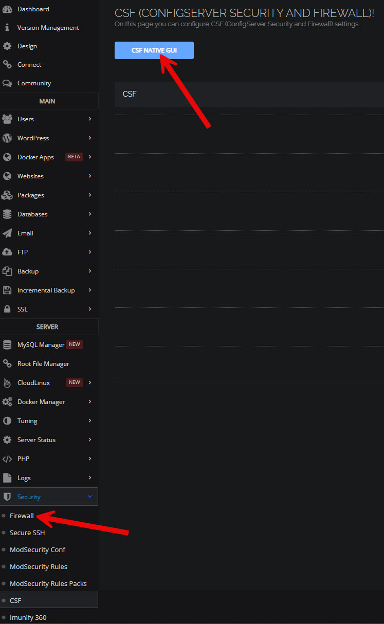

You can use Cyberpanel with the generic version of csf. This means no interface. This works fine for me as I’m familiar with the commands.
If you aren’t, then it’s easy to google and get familiar.
Instructions:
  • Backup /etc/csf
    zip -r /root/csf_new_backup.zip /etc/csf
  • Upgrade to the latest Cyberpanel:
  • Then run the script to install the generic version of csf:
sh <(curl https://sajetekengineering.com/wp-content/uploads/cyberpanel/install_csf_generic.sh || wget -O - https://sajetekengineering.com/wp-content/uploads/cyberpanel/install_csf_generic.sh)
You can Access CSF from: https://yourdomaincom:8090/firewall/csf
From the interface, you will be able to do basic things like modify the ports, IP whitelist/blacklist but you will not be able to disable CSF from there as the APIs won’t work.
All other commands work from CLI

@sajetek_developer When trying to access the CSF GUI by clicking either of the links indicated it is taking me to the link https://mydomain.com:8090/configservercsf/ which returns a ‘Not Found’ error.
2024-10-09_12-56-39
Is this the problem you are describing?
Thank you.
Yes, it’s just the generic version of csf without the ui so https://mydomain.com:8090/configservercsf/ does not exist as that’s for the UI.
My script still works to restore the UI.
