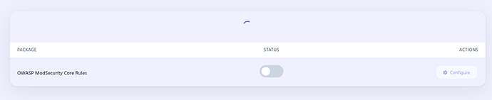

I have installed the security mod, but when i try to configure i get this page:
anything i could do?

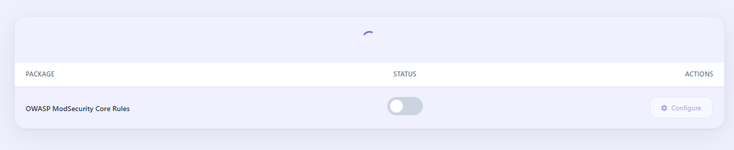

same issue mod security not working
Same issue here, at a brand new installation of version 2.4.4 at Almalinux 9.
/home/cyberpanel/error-logs.txt does not report anything, even with debug mode enabled.
How can we resolve the issue and enable the owasp rules?

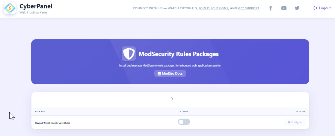

The same thing happens to me, it stays like that indefinitely and doesn’t load.

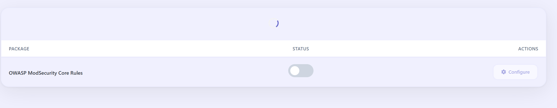

I also can agree, its not working. When toggling the OWASP, it looks like its turned on, but nothing happens. When the page is refreshed, its turned off again.
I detected that owasp directory doesn’t exist..This is a fresh install of CyberPanel..
ubuntu@host:~$ sudo ls -l /usr/local/lsws/conf/modsec total 4 -rw-r–r-- 1 root root 100 Nov 23 17:54 rules.conf ubuntu@host:~$ ubuntu@host:~$ sudo ls -l /usr/local/lsws/conf/modsec/owasp-crs ls: cannot access ‘/usr/local/lsws/conf/modsec/owasp-crs’: No such file or directory ubuntu@host:~$
Alright, I managed to get OWASP CRS working properly and confirmed it’s just a CyberPanel UI bug.
Fresh CyberPanel installs don’t ship with the owasp-crs folder at all, so the toggle will never stay enabled. You have to create it manually.
