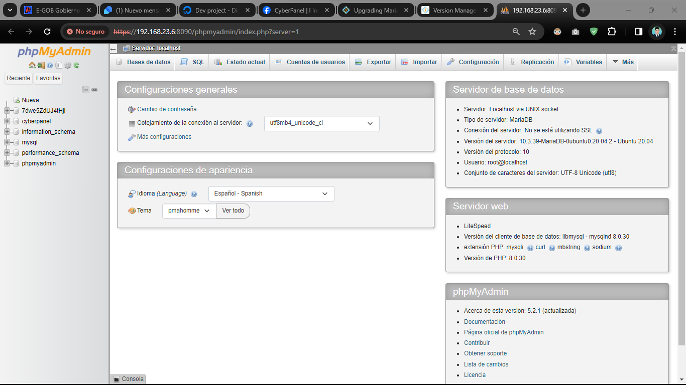

I have installed the new cyberpanel 2.3.5 update on Ubuntu 20.04lts and MariaDB remains obsolete

So what’s the latest advice to upgrade MariaDB on Ubuntu? Will Cyberpanel do this automatically?
