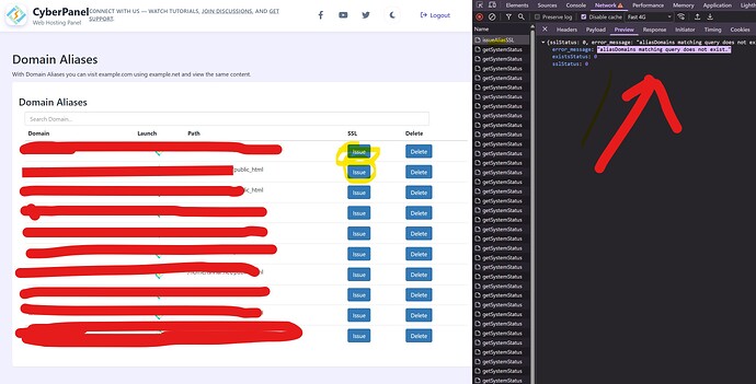

On /websites/<example.com>/domainAlias I added domain aliases. After adding an alias:
  • Clicking Issue SSL for that alias fails with the server error:
    aliasDomains matching query does not exist.
  • The Delete button does not send any request to the server at all. When I tested with an external JS POST request the server log shows the same aliasDomains matching query does not exist. error.

  1. Go to: /websites/<master-domain>/domainAlias (example: /websites/example.com/domainAlias)
  2. Add a domain alias (fill alias domain and save).
  3. After alias is added, click Issue SSL for that alias.
  • Observe server response: aliasDomains matching query does not exist.

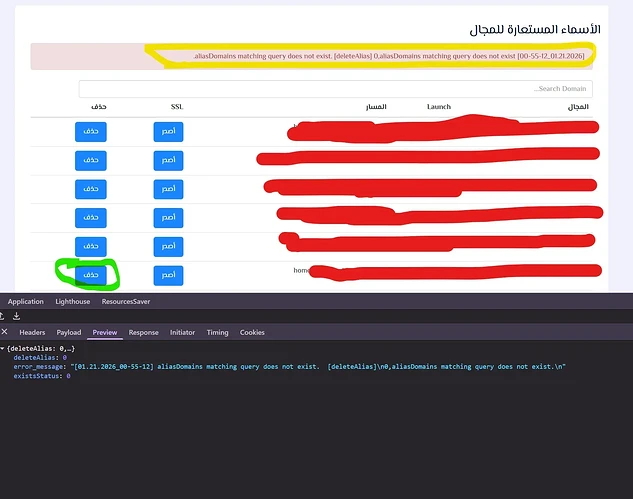

  1. Try to delete the alias via the Delete button in the aliases table.
  • No network request is sent (no POST in browser Network tab).
  • When testing with a manual JS POST to the same endpoint, server log shows:
[01.21.2026_00-55-12] aliasDomains matching query does not exist. [deleteAlias] 0,aliasDomains matching query does not exist.

Django error when clicking Issue SSL
DoesNotExist at /websites/issueAliasSSL

Manual delete test log (server)
