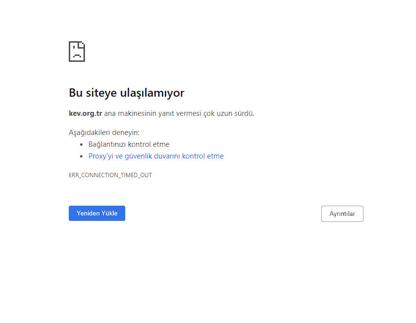

The website works with https:// but when it sends a request with http:// it gives a time out error.
Post screenshot of the error when you visit the webpage
@josephgodwinke
We are getting the following timed out error.
Thanks for help. We gave up on CyberPanel and quickly solved the problem with another panel. You can close the topic. have a nice day.
