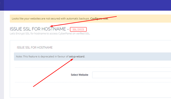

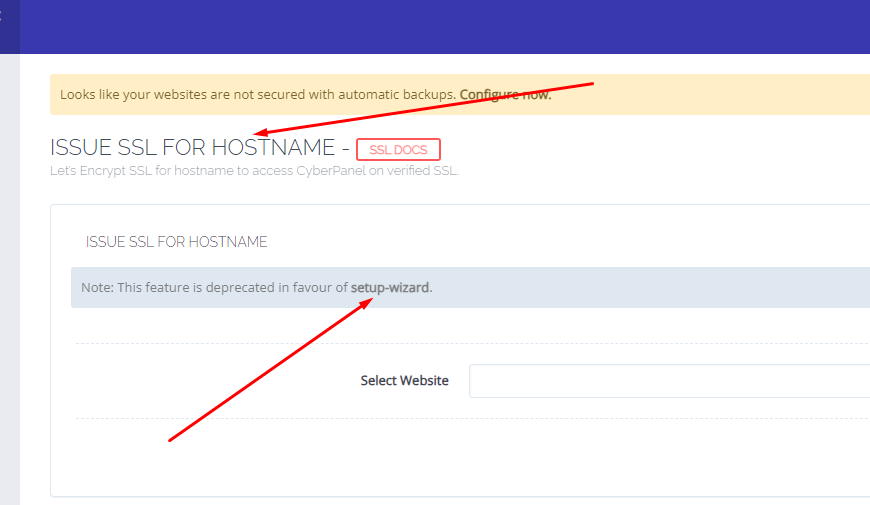

I encountered a similar issue when the SSL keys had a problem, and their MD5 hashes mismatched. Although HTTP was working, I was unable to complete a CyberPanel-to-CyberPanel website migration because SSL was required. I tried various solutions, but regenerating the SSL for the hostname through the Setup Wizard seemed to resolve the issue, allowing HTTPS to work (albeit with a ‘not secure’ warning).
