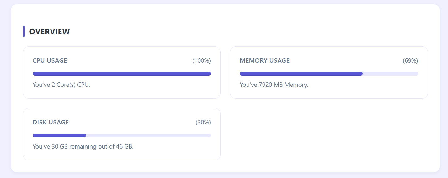

My Cyberpanel CPU & RAM usage is very high. What is the reason that caused that to happen?
Yes, these are stats for a new cyberpanel installations without any website or app running. What actions can I take to resolve this?

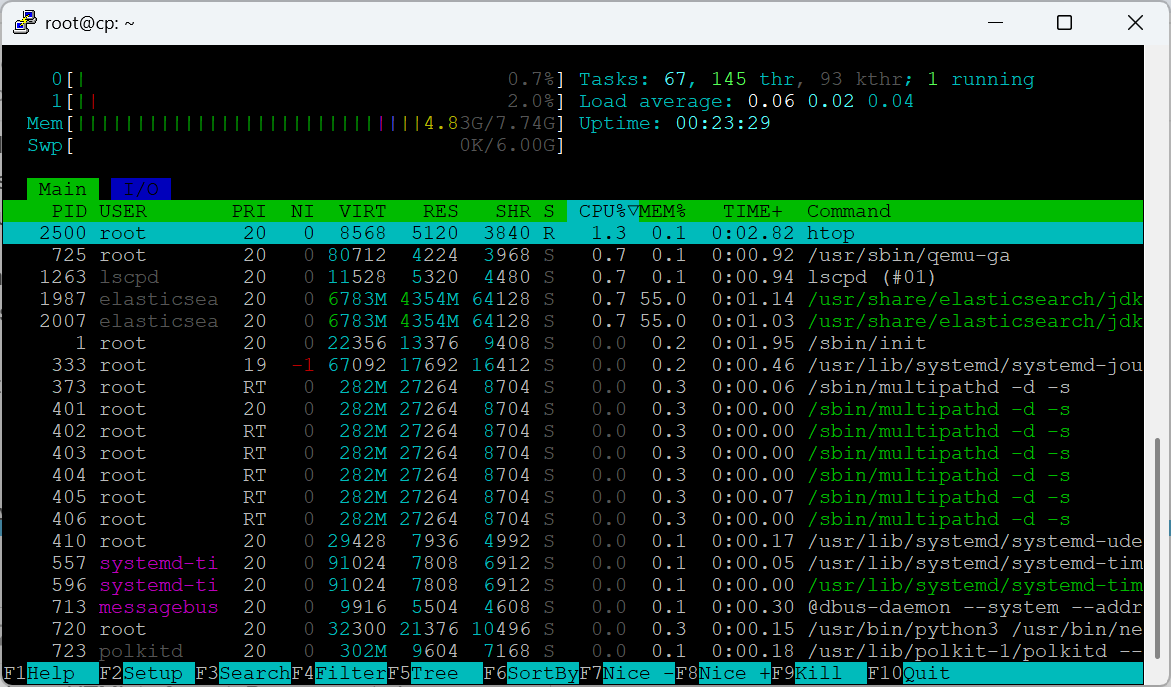

Does cyberpanel still not fully support Ubuntu 24.04 LTS? CPU in shell looks ok.
While CyberPanel can technically run on low-resource servers, in practice it’s best to have at least 32 GB of RAM for stable and efficient performance.
From the image, it’s clear that Elasticsearch is consuming most of the memory, which is expected — this service typically requires a minimum of 8 GB of dedicated RAM just to operate properly. On top of that, you also need RAM for the operating system, hosted websites, and CyberPanel itself.
So, having only 8 GB of RAM is definitely insufficient for this kind of workload.
I’d recommend upgrading the server’s memory to improve performance and overall stability.
