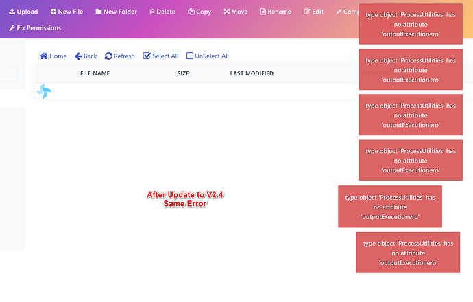

When opening the file explorer the following alert opens
error type object ‘ProcessUtilities’ has no attribute ‘outputExecutioneroo’
I can’t open any folder

I am getting this error as well ![]()

I updated, but I still have the same problem, all domains show the same error

I am getting the “type object ‘ProcessUtilities’…” error after updating to 2.3.8 according to the October 29 patch.
