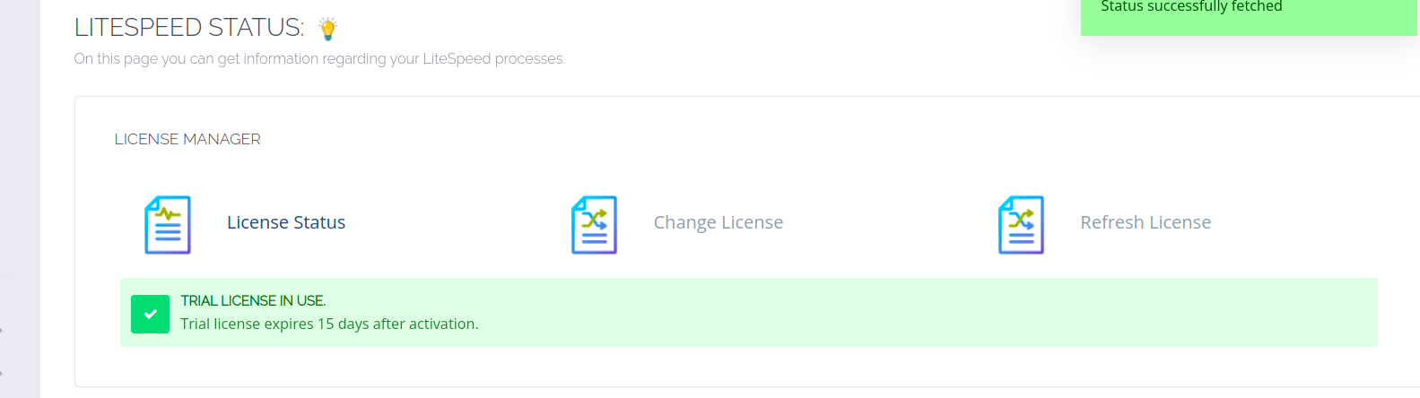

I have a problem with latest cyberpanel update, process completed but let my server completely down, only can access to cyberpanel (8090), but not openlitespeed (7080) and when i go to service status it shows litespeed!
