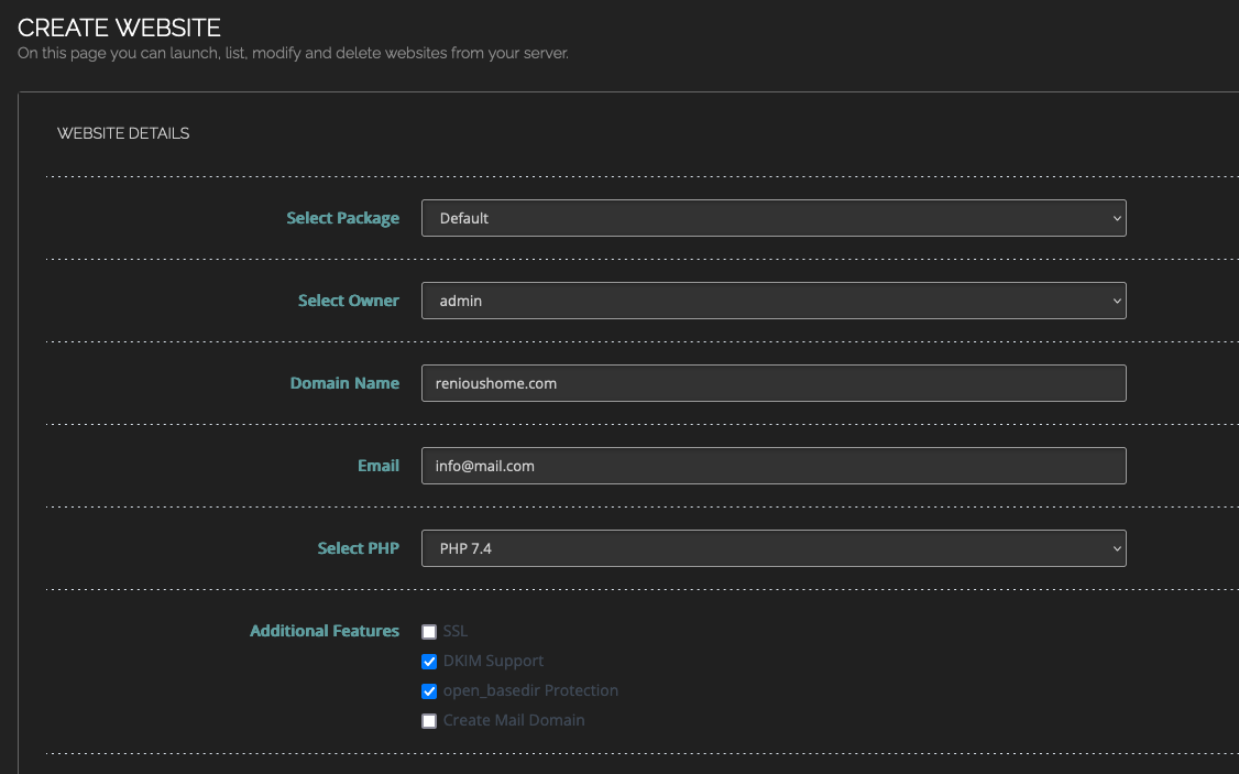

It’s not the installation that does not work. It is when you want to manage it. If you add it’s ok, when you click on manage, then you get the error
Now go to Websites → List Websites → Manage. then you get the below
Hi again, when you click MANAGE then that’s when I get the error! If I add another domain which is not .com, then I can manage, add wordpress, DNS… but NOT with any .com domains

everything working
