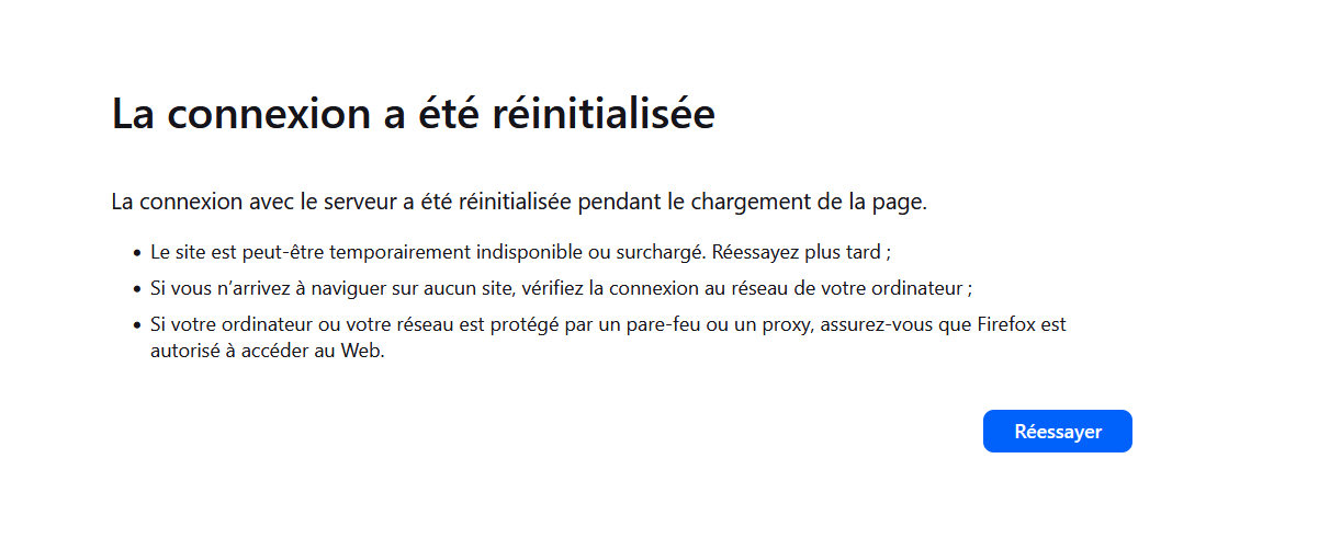

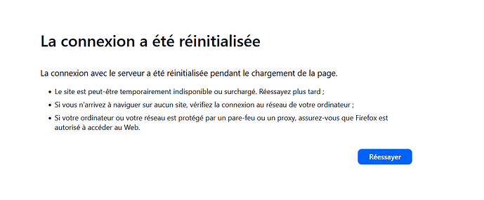

After the update all my sites no longer work with the message "The connection has been reset"
Good evening I’ve been having problems since I updated, all my sites don’t work anymore with the message “The connection has been reset” thank you
Try to disable ModSecurity engine and check again.
I’ll try to figure out where is the problem after the update…I’ll be back
Finally got it work by disable ModSecurity engine, downgrade it and reinstall it again.
