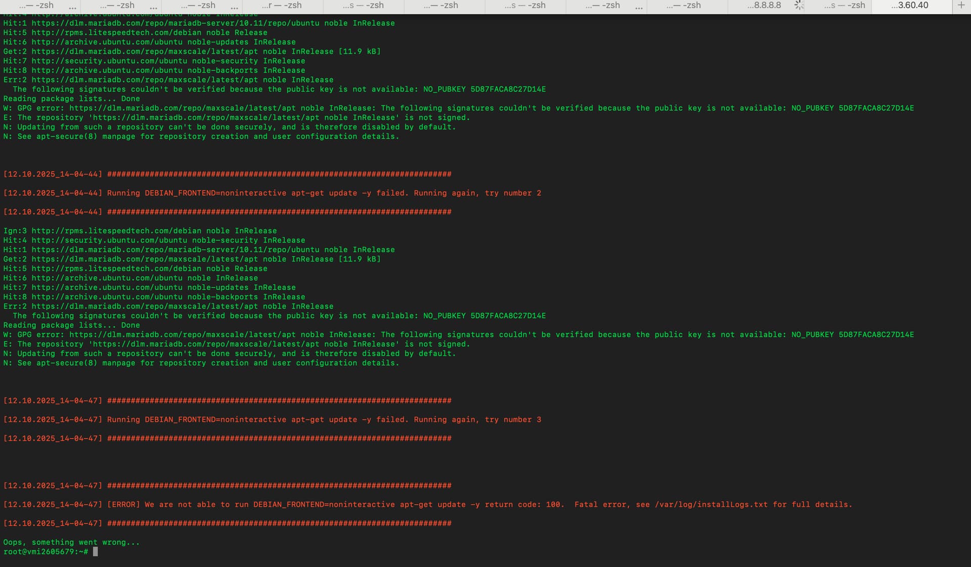

New install today 2025/12/10
MariaDB Server repo is signed correctly, but MaxScale repo is not
Get:8 https://dlm.mariadb.com/repo/maxscale/latest/apt noble InRelease [11.9 kB]
Err:8 https://dlm.mariadb.com/repo/maxscale/latest/apt noble InRelease
The following signatures couldn’t be verified because the public key is not available: NO_PUBKEY 5D87FACA8C27D14E
Reading package lists… Done
W: GPG error: https://dlm.mariadb.com/repo/maxscale/latest/apt noble InRelease: The following signatures couldn’t be verified because the public key is not available: NO_PUBKEY 5D87FACA8C27D14E
E: The repository ‘https://dlm.mariadb.com/repo/maxscale/latest/apt noble InRelease’ is not signed.
N: Updating from such a repository can’t be done securely, and is therefore disabled by default.

MaxScale releases, as of yesterday, started being signed with a new key. The mariadb_repo_setup script has been updated to automatically install the new key, but for existing repositories you’ll need to:
curl -LsSO https://supplychain.mariadb.com/mariadb-keyring-2025.gpg
sudo mv mariadb-keyring-2025.gpg /etc/apt/trusted.gpg.d/
sudo apt update
On RHEL distros, you can do the following:
sudo rpm --import https://supplychain.mariadb.com/MariaDB-Enterprise-GPG-KEY-2025
