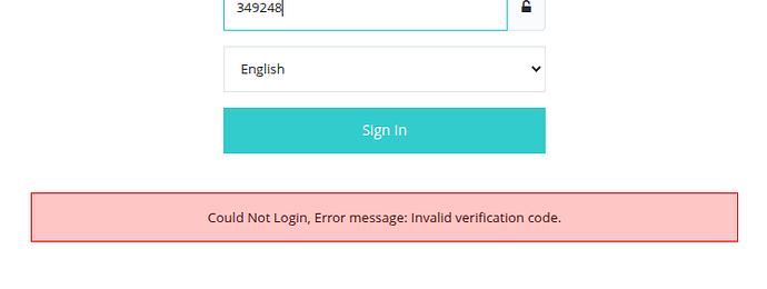

Two-Factor Authentication is unstable in Cyberpanel. Sometime I get this message even though everything is correct.
I’m on Linux using Clockode for the codes.
Please fix this problem. It’s so annoying I might disable Two-Factor Authentication altogether.
Thanks
clear the browser cookies and try. I had the same and this solution works for me.
I had issues also. My 2FA only works if the systemd-timesyncd service is actively running.
Me too, how to fix
