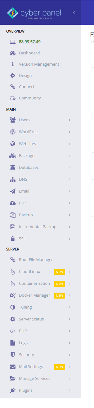

Hi Thanks for the quick response, I am very new to this platform and I don’t seen any terminal to run this command, as I said I haven’t been developer who set this up.
Ask your server provider how you can access your server using SSH or VNC. They should help you with docs or tutorials to achieve this.
