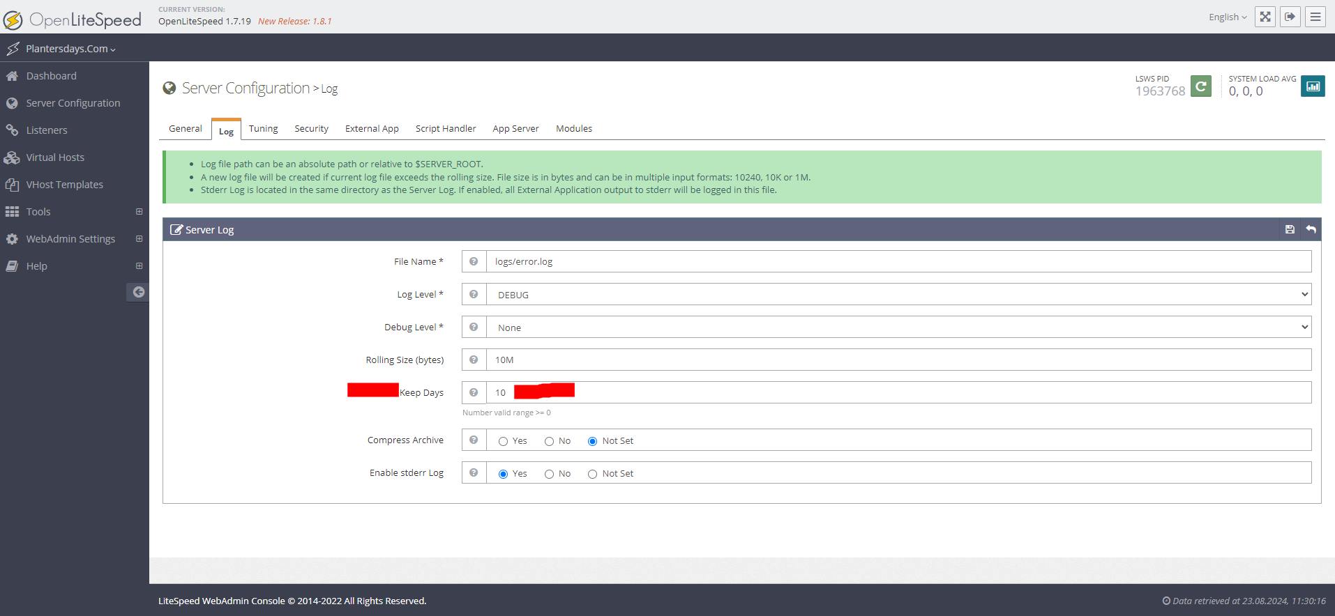

This is most likely all logs from LiteSpeed server.
Unfortunately Cyberpanel installer does not correct logging settings on the server.
I bet $10 that space is eaten up by logs, and you are in for a surprise here: /usr/local/lsws/logs/
You can see in the screenshot that I put 10 days on the log rotation. By default there is nothing there and the logs grow indefinitely. I recommend to set the same for hosts.
