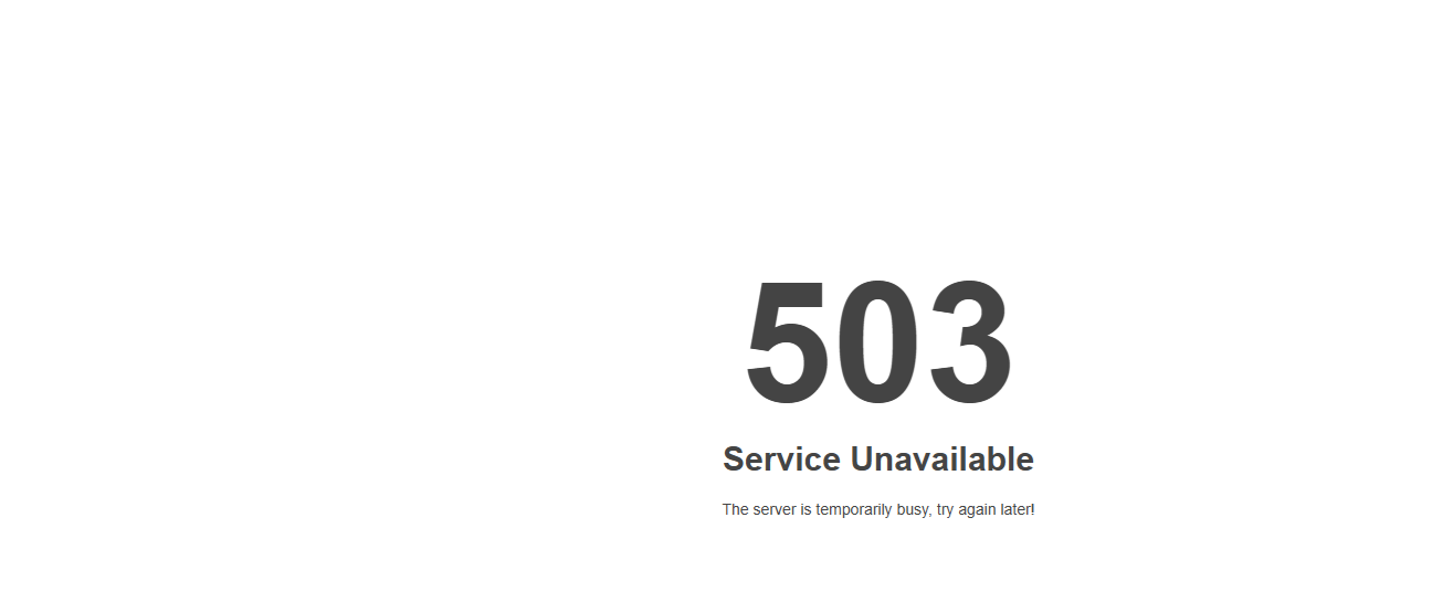

I have the same issue. Tried to upgrade from 2.4.2 to 2.4.4, now I have error 500 when trying to domain.com:8090. Websites working fine

but anyway, after this, still getting this error:
[2025-09-27 14:41:56] Added web server users to lscpd group and fixed SnappyMail ownership
  % Total    % Received % Xferd  Average Speed   Time    Time     Time  Current
                                 Dload  Upload   Total   Spent    Left  Speed
  0  1240    0     0    0     0      0      0 --:--:-- --:--:-- --:--:--     0
Seems something wrong with upgrade, please check...
