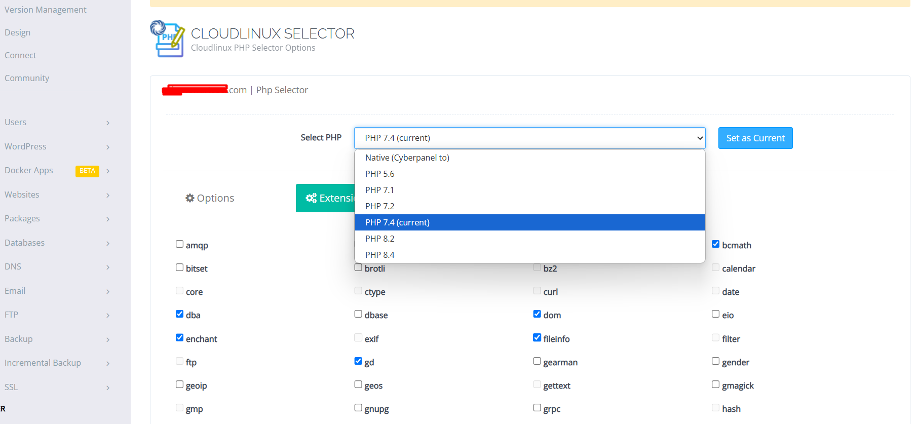

Sevin #8
how do i use cloudlinux php selector in domains?
Se
Sevin #10
and how to activate an extension in php 7.4 I need pdo_dblib, pdo_sqlsrv

Rana Muhammad Usman Nasir #11
On Redhat based systems I got
[root@ip-172-31-15-45 ~]# yum search pdo
Last metadata expiration check: 1:36:56 ago on Mon 06 Feb 2023 04:37:45 AM UTC.
============================================ Name & Summary Matched: pdo ============================================
lsphp71-pdo-debuginfo.x86_64 : Debug information for package lsphp71-pdo
lsphp72-pdo-debuginfo.x86_64 : Debug information for package lsphp72-pdo
lsphp73-pdo-debuginfo.x86_64 : Debug information for package lsphp73-pdo
lsphp74-pdo-debuginfo.x86_64 : Debug information for package lsphp74-pdo
lsphp80-pdo-debuginfo.x86_64 : Debug information for package lsphp80-pdo
lsphp81-pdo-debuginfo.x86_64 : Debug information for package lsphp81-pdo
lsphp82-pdo-debuginfo.x86_64 : Debug information for package lsphp82-pdo
lsphp71-pdo.x86_64 : A database access abstraction module for PHP applications
so doing yum install lsphp74-pdo similarly you can search for pdo related packages or other lsphp packages on ubuntu based servers to, i think its apt-cache search packagename for ubuntu.

RM
Rana Muhammad Usman Nasir #13
no, first show me output of yum search pdo, by the way you are still on cent7? Upgrade to some better os now.
RM
Rana Muhammad Usman Nasir #15
Just run this command, also I advice you to upgrade your OS too.
RM
Rana Muhammad Usman Nasir #17
Alma 8 or ubuntu 20
I think pdo is installed as you can see, pdo dblib is not. Honestly I don’t have much info about that, but check with
/usr/local/lsws/lsphp74/bin/php -m | grep pdo
Also lets not continue this discussion as this post is entiretly about different thing, you can make a fresh thread.
killall lsphp
This will restart PHP so might as well fix your issue.
