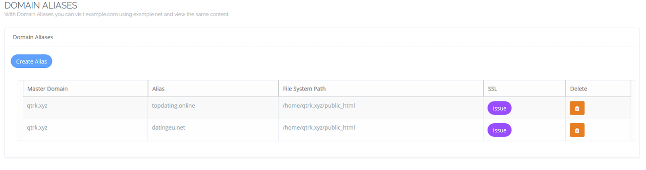

Recently I’ve Facing an Issue on the Latest Version on Cyberpanel.
Screenshot: https://i.postimg.cc/pLJgj38f/p.png
If I Add More then One Domains on Domain Alias
Both SSL Get Conflict or One Get Removed from each other.
Can got issue SSL for Two Domains
Error Screenshot: https://i.postimg.cc/T1nk6WJV/p.png
Please Tell Me How can solve this issue.
